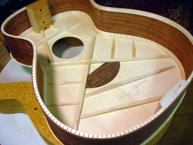

I'm having a problem with a grand concert gtr, It has engleman spruce top (standardish thickness) & braces (5/16" thick X braces, 1/4" thick elsewhere) It sounds too dark. Cocobolo bridge, ebony bridgepins, EIR bridge plate, grenadillo B & S, corian nut & saddle. (planning to upgrade to bone, maybe bone bridgepins too)
I was thinking of making a sister guitar, but carpathian top and braces. I think the engleman is at fault. It doesn't sound that good strummed (headroom)
Any other ideas?
KEVIN GALLAGHER, what sayest thou? Since you'll see this soon...
Construction pic below - yeah, so what IS the deal with the tone bars layout? I don't know why I did that...
Terry Stowell38782.4814467593

[QUOTE=Terry Stowell] I'm having a problem with a grand concert gtr, It has engleman spruce top (standardish thickness) & braces (5/16" thick X braces, 1/4" thick elsewhere) It sounds too dark.
Terry, Terry, Terry...don't blame the wood!    By "dark" I'm thinking you mean you're getting a muffled, mid-rangey tone? If so, I think it's because you've overbuilt your bracing, and the top is just not moving enough. You've already mentioned a major cause...those tone bars are just too long and too hefty! Shave those puppies down to about nothing toward their ends. It's hard to tell from the photo--is your "X" lap joint capped? Alan Carruth says it's not done until it is. 'Nuff said. You could also take some more wood off the sides of just about all your bracing. Taper 'em toward their tops and they'll retain their strength while allowing the top to vibrate better (less mass). Take it slow, do one part at a time, restring and hear how it sounds. Oh, and don't punch a hole through the top (did I mention to take it slow?)!
PostPosted: Mon Mar 06, 2006 9:39 am
Posts: 1584
Location: PA, United States
Thanks.
I thought of shaving from the sides of the braces, and thought it may be overbuilt a little. I don't have a small enough plane to do the job though. (anyone care to lend me one?)
I have to still glue the tongue down and change out the nut, saddle, & br pins too. Any thoughts on slotted VS. non slotted pins?
Also I was planning to use 2, not four finger braces. I guess on a G. C. I could get away with that.
I was planning to take it to Kevin Gallagher's when I visit & see what he says after hearing it.
Now after 3 months of playing it, I'm ready to start fine tuning the details
Thank ye all
Terry Stowell38782.7376273148
PostPosted: Mon Mar 06, 2006 9:52 am
I thought of shaving from the sides of the braces, and thought it may be overbuilt a little. I don't have a small enough plane to do the job though.[/QUOTE]
You could use (or make) a small scraper to do the job. Just be sure you round and tape the outer edges so you can't cut into the top. That way, you can feel the brace as you guide the scraper, and you'll have less chance of chipping or tearing the wood. Start with the tone bars, take it slow, see how it sounds and proceed from there (and cap that "X" intersection, if it's not!).
